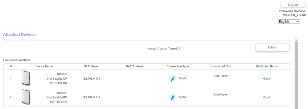

Powered ON the RBR and let it come back to ready. I noticed that the front LED seem to blink longer than expected though I had internet services already after my wired PC connected to the RBR. Logging in to the RBRs web page showed Internet was GOOD. Front LED turned OFF.

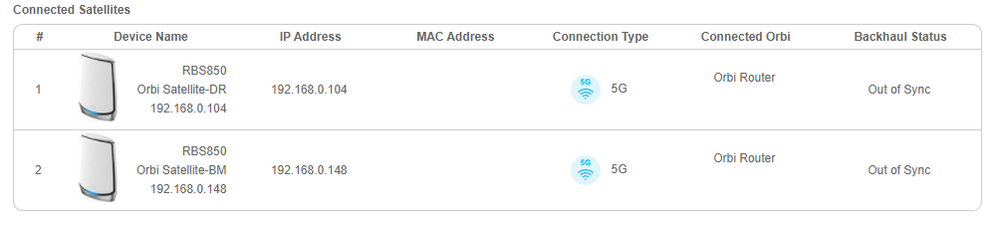

Powered on 1 RBS at a time. RBS seems to take a bit long to get synced up Wirelessly.
I noticed that a Out Of Sync message was seen on the RBRs web page:
So I gave the RBS a few more minutes and eventually that status changed to GOOD on the RBRs web page.

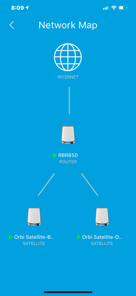

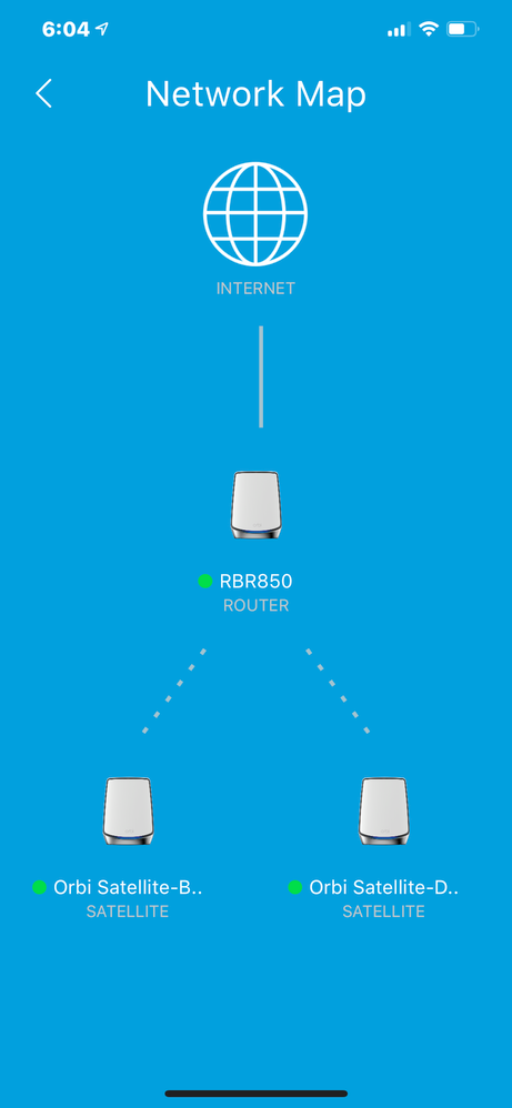

Orbi app:
I turned OFF the RBS and went to dinner and came back.
Powered ON the RBS again one at a time and let them wirelessy sync succesfully.
Plug in the ethernet cable into both and connected the other end to the RBR, one at a time.
The status one the RBRs web page soon turned from 5G to Wired:
Orbi app:
