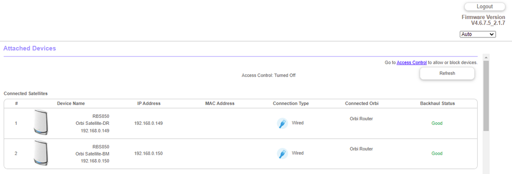

Firmware Version: V4.6.7.5_2.1.7
dumaos: v3.0.410
seal: v2.1.5.21-0
seal_services: v2.1.5.9-0
armor-bd: v2.2.100.3
spc-circle: v3.25.0.2
CPU Load: 10.96%
Memory Usage(Used/Total): 332 MB/874 MBSystem Uptime: 2 days 05:01:09
No issues seen thus far. Going to connect the RBS via ethernet and see how the do now:
