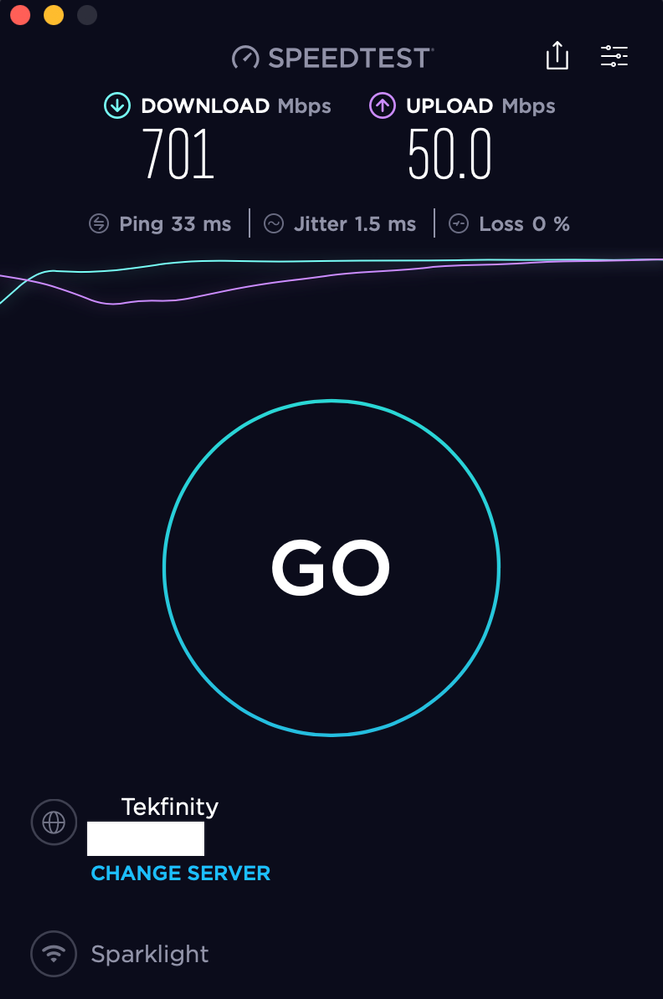

Just manually updated the satellite and router (RBK852) & all seems well...will report any issues I come across as I inspect things....
Curious, what is the "Supports the new device notification feature?"Me as well. Maybe something do to with the Orbi app? I didn't see anything in UI that stood out. Just that wifi devices are being reported as wireless even though they are connected to a wired RBS.
Wireless speed results with a Mac Book Pro (AC):
