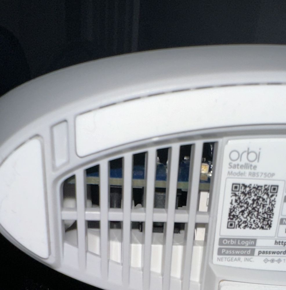

      Well like I mentioned, I don't have my original Router to compare, but here is an image of one of the SATs -  The Router is clearly a RBR750 (no P after the written model) - and the sats are RBS750P in the image. These models also reflect in the web GUI.

        Interesting. Where did you get this set from? Have never need a P model in the model name. Wondering if this was from some special market or from an ISP maybe?
        Ok, I see, there was a P series kit. RBK750P, which seems to be a 350 series hardware, RBR and RBS 350:
        https://www.netgear.com/support/product/rbk752p/#download
        So this is v6 FW specific for this model kit then.
        And you got a actual RBR750 which doesn't support the v6 FW. Never did. So your system won't work together with the RBR750 actual and these RBS750P (RBS350) satellites that use v6 FW.
        What happened to the original RBR750P router unit?
        Only thing that you can do, if your going to keep the RBR750, find you some RBS750 actual model# satellites and then get them updated to v7 FW and then your system will be good to run.
        These are actual RBS750s: https://www.netgear.com/support/product/rbs750/
