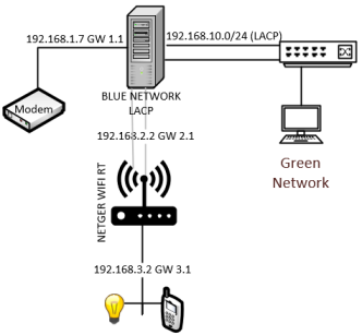

Hello community, newbie here, at least with limited networking knowledge.
I'm using pfSense (under Proxmox) + Netgear ORBI WiFi in AP Mode, and everything works perfect. Now, ORBI RBK850 is able to use LACP 802.3ad (WAN+LAN) and I tried to enable it. Unfortunately such setting is supported only with ORBI in router mode. Enabling the LACP on Proxmox, as I already did for GREEN network, everything works perfect except for the fact that ORBI, used as router, enable NAT as any routers do.
So, my situation now is the following. All WiFi devices get 192.168.3.x IP and they are able to surf internet without any issue. Problem is that, as expected, PfSense gets ALL connections with 192.168.2.2 and that's bad for me, because I need to have the original IP to be able to apply specific rules on WiFi interfaces. To be more clear, I have several WiFi lamps/ceiling lights handled by Home Assistand in GREEN network (192.168.10.x). Home Assistant expects different IP for each lamps to be able to map it. But because of Wifi NAT it gets only 192.168.2.2 from all WiFi devices.
I cannot figure out I can have back all the single WiFi IP to be able to identify in pfsense the single devices. Something like disable nat in orbi but keep LACP?
Any clue?Thank you
