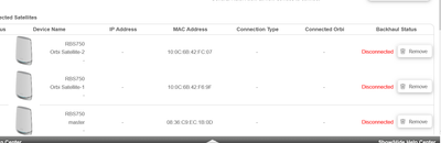

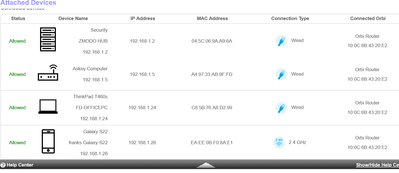

I have 3 satellites and 20 devices on my network . The app says all satellites are disconnected and only 4 wired device are connected plus my phone in 2.4g. I have 5 firesticks streams right now so I...

The firmware is V7.2.6.31_5.0.24 the sat say disconnected. My phone and wife phone are currently on the network and working I see the mac address and ip address on the phone and they dont show up at all in the app or computer, Only 4 wired devises and 1 firestick show as connected .

And you have RBS750s?
May need to factory reset the RBS and RBR and setup from scratch.
v.31 has issues that users have been posting about, recommend downgrading the system back to v.21 FW:
For this PDF process to manually downgrade the RBS first, then RBR lastly:
- fdelmo10Oct 26, 2024Tutor
2nd replied - I unpluged and disconnected one wired device . It still shows as connected. I think this is frozen. Can I try and remove 1 satellite and reinstall thru the ap ? I am trying to think of things that give you experts more info
