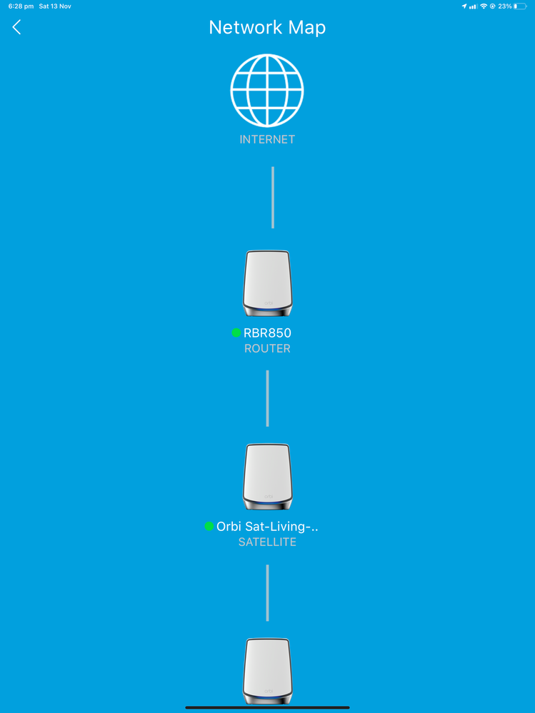

Sometimes the topology map shows a standard router and two satellites directly conneted to the rounter an sometimes it shows a router --- satellite --- satellite configuration.

Tried to post a screen image but they seem disabled?
- the screen image I tried to post showed the offending satellite as having an IP address, a MAC address, a wired connection and a "good" backhaul status. The satellite that is working shows the MAC address of the router in addition to the information above.
