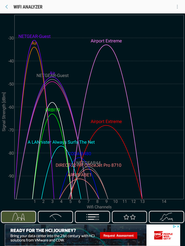

      • FURRYe38's avatar
        I'll see if mine does the same thing...
        Guest Network is seen on my RBS: Air SSID
        AIR Guest Network Enabled
