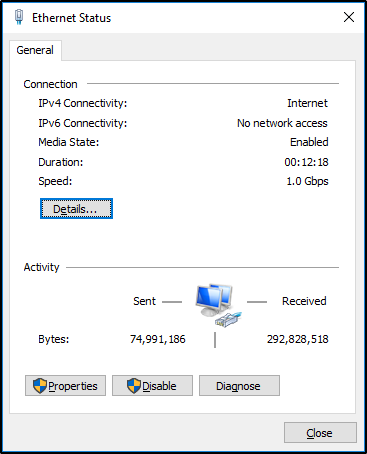

  • Wired PHY: 1,000Mbps or 1Gbps (Screenshot)
    • Control Panel --> Network and Internet --> Network and Sharing Center --> Ethernet --> Speed
