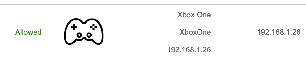

ORBI CBR750 Static Addresses are not static?
My Orbi CBR750 system currently assigns IP addresses automatically. I have assigned Static Addresses to many of my devices.  I allow my grandson, who lives on the other side of the duplex house, to use my WiFi with his XboxOne.  Anytime he gets on, the XboxOne takes an IP Address that is not being used but was assigned as a static address I set up for the printers or TV.  Those units will not work when he is on with the Xbox.  The Epson printer (192.168.1.26) will report that another device is using the address.  I am very familiar with using Static Addresses with EERO, TP-Link and other Modem / Router units. So, I must not be doing it right with the Orbi
Please advise the correct way to set a Static address with the ORBI.

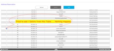

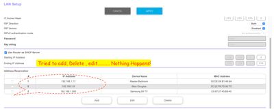

      • PatronBlair's avatar
        PatronBlair
        Tired to Reserve IP Addresses - Nothing works -  Power Down, Devices, the Orbi, Restarted , Refreshed, Unit does nothing - Can Add, Delete, Edit.......  Ziltch.   Sick of screwing around with it.  Will search for Replacements for both CRB750........ Mass & Florida.
