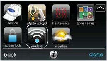

    Select the WIRELESS from the menu screen

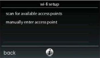

    • Touch SETUP A WI--FI CONNECTION to begin the process.
    • Next, touch SCAN FOR AVAILABLE ACCESS POINTS.

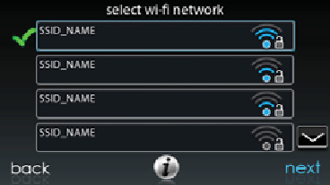

    After selecting the "Wireless" Icon are getting the screen below?
    When it's done searching does any of your SSIDs come up in the WiFi Networks area, are you seeing your WiFi(s)? And if need be scrolling to another page . . .

      Hey there, thanks for the fast reply!  You actually reminded me of a detail that I meant to include but forgot to... When I perform a scan for wireless networks, it shows 3 instances of my non-guest SSID and 2 instances of the guest SSID.
