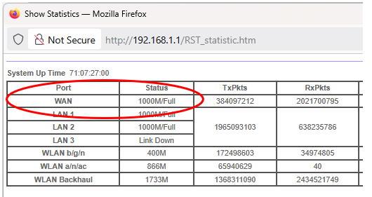

I have Spectrum Gig with 40 mbps upload. I cannot get the Orbi system to hit more than 100mbps since upgrading.100Mbps is a "special value". Does the Orbi report more than 100Mbps (even 101 or 102)? Or does it always report less than 100Mbps?
Would it be convenient to check the Orbi web interface, Advanced Home Page, and select "Show Statistics".
What speed is displayed for the WAN Port?

- DarthSwedeAspirant
I didn't check the WAN port, but it was always less than 100
