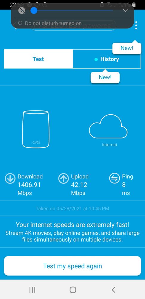

    Initial testing using the RBR850 to directly run Speed Test via Orbi app is 1,406.9 Mbps (my plan is 1,200 Mbps)... :)
    Of course since the RBR850 only has a 2.5 Gbps WAN port and NO 2.5 Gbps LAN ports (shame!), I will not be able to (currently) get more than about 950 Mbps from any single connection (gigabig LAN limitation including overhead).
    But at least I can be downloading at a full 950 Mbps via LAN port ethernet connection and still have the other 456.9 Mbps available for the rest of the network (without the need for link aggregation - LACP).
