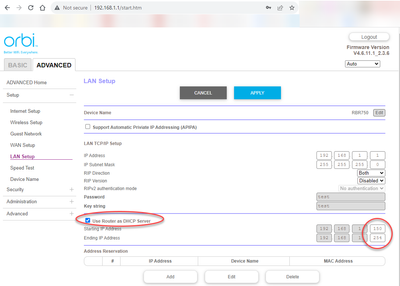

If that doesn't fix it, go into your Netgear Admin, Advanced, LAN Setup, and change the starting IP address of your DHCP server to something higher.I set mine to 150, but I am going to experiment when no one else is home to see if a lower range will still work, and to take it off altogether to make sure this was, indeed the problem, and not something a simple router reboot would have fixed.

I just changed my DHCP to only server 192.168.1.150 thru 254 since the Azure VPN -- which ultimately serves up a 10.193.xxx.xxx range -- seems to favor the lower levels where Orbi likes to live, and rebooted the router.
Been connected for about a half hour now with no kickout. Fingers crossed. Since I sometimes can stay connected for a couple hours, I'm guessing it's an IP conflict and others on this forum have solved the problem this way (although none of them - dammit - ever mention what range they switch their DHCP to, which can be infuriating when you're trying to emulate their success).

I don't know what to tell you, CrimpOn, but others have reported resolving the problem this way, and since I made that change hours ago, the Azure VPN has not dropped me even once.
Unless I just got lucky again? For...how, if it's not an IP conflict? then I'd say this solution worked for me.
Still going to give it a few days before I mark this as the answer.
- WiscWildcatAspirant
I'm going to rule this IP change a successful fix -- I'm still connected, two days later, including over two nights. Gotta break that string, though. Windows wants updates.
So, to anyone else with this issue -- first just try a simple Router reboot just in case that's all that's needed.
