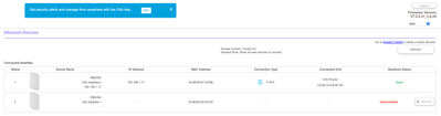

- vdotmatrixJun 15, 2024GuideOKAY...I changed the password to access this thing and got in. The RBR firmware is current I cannot tell if the satellites are current. I am in the attached devices section and see this screen. The two satellites bounce between connected and disconnected. - FURRYe38Jun 15, 2024Guru - Experienced UserAh, there is the reason, you have RBS350s. These are NOT compatible with v7 of FW. You need to downgrade the RBR back to v4 version of FW: Please disable the auto update feature as well on the RBR after downgrading the RBR back to v4 so it won't auto update back to v7.
