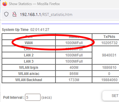

    Could you please check the connection between Orbi and AT&T devices by looking at the Orbi web interface
    (http://orbilogin.net ) on the Advanced Tab. Click the Blue Box Show Statistics in the upper right box.
    This will display the speed of the various router connections:
    Does the WAN port display 1000M/Full, or does it display 100M/Full?
    If it displays 100M/Full, that is an indication that the AT&T device and the Orbi router have auto negotiated the maximum speed that they support over the link to be "Fast Ethernet" (100megabits/sec).
    https://en.wikipedia.org/wiki/Autonegotiation
    This often indicates a problem with the Ethernet connection, such as:
    • A fault with the cable
    • A fault with the RJ45 connector on one end (or both ends) of the cable
    • A fault with one of the RJ45 jacks, perhaps a bent pin
    If this is the case, taking a close look at the RJ45 ports and replacing the cable are good steps.
