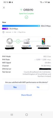

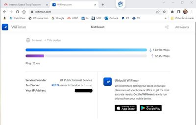

Connected the orbi router to the ISP modem and followed the setup instructions in the orbi app. Let the router setup and do it's thing. At this point I should note and this is where your other post helped, I did not have the satellites turned on so the app did not automatically recognise and connect them. I chose to set them up later. I then connected the satellites one by one, NOT at the same time.
The satellites are on wireless backhaul.
It would seem that the orbi system does not like the router and the satellites set up at the same time and need to be done one by one which seems crazy to me.
Guess what? I'll let the images do the talking....
The first one is a laptop connected through a docking station to a satellite via an ethernet cable
