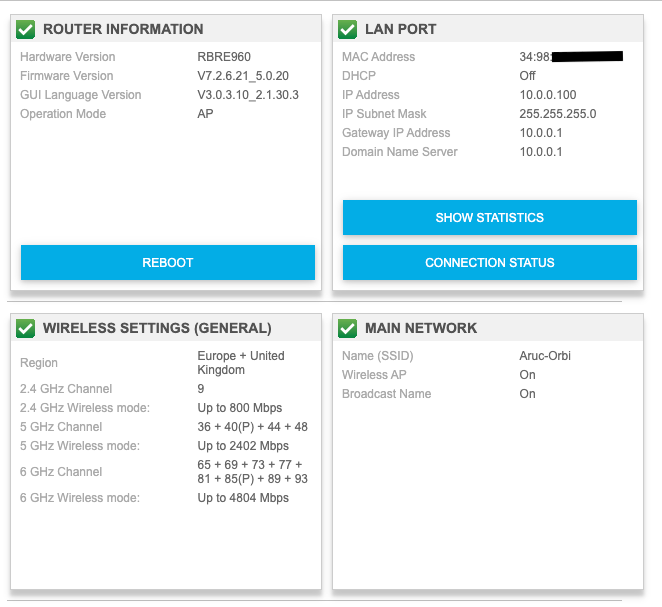

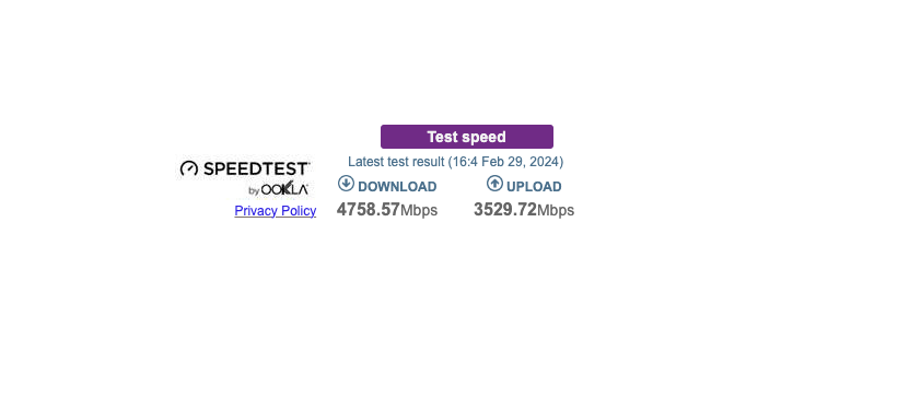

I have a 10GB router connected with CAT8 Cable into my Orbi RBRE960 10GB internet port on AP mode. Unfortunately, I can't see more than 5GBPS down and 3GBPS upload speed.

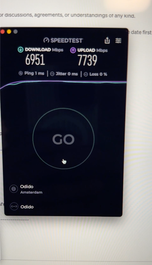

When I am connected to my router's 10GB port directly with my laptop, I see 8GBPS .

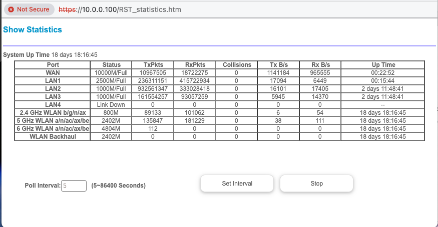

What are the connection rates seen with your test device connected to the RBRs LAN ports?
There's only 1x 2.5Gb LAN port so this will max out here. The other LAN ports are all 1Gb so they will be maxed out here as well.

Thanks for the replay, and Firmware Version V7.2.6.21_5.0.20, I can confirm that on the router directly, I see 8GBPS using my laptop and 10GBPS network card.
Testing is done on the webgui of the Orbi, on the 2.5GB port i can reach the 2.5GB speed.

You should see 2.5Gb speeds max on the 2.5Gb LAN port on the back of the RBR in AP mode...
