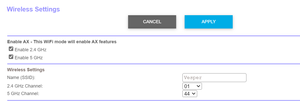

Hello! I believe my modem router is disabled. Kindly confirm with the screenshot.
- KevinLiTDec 06, 2022NETGEAR Moderator
Hello rhettarded ,
Thank you for your post!
I can tell that the SSID broadcast for your ATT modem has been disabled. Most of the time connectivity issues occur when there are two routers on the same network due to compatibility issues with the NAT protocol. If your ATT modem is still routing then this can cause stability issues for your network.
Try changing your RBR850 to AP mode then check for stability issues.

- CrimpOnDec 06, 2022Guru - Experienced User
The screen shot appears to indicate that the AT&T WiFi is disabled, but the AT&T device itself is in router mode.
It has assigned the IP address 192.168.1.107 to a device called RBR850 and the status is "on".
If you bring up the Orbi web browser interface and click on the Advanced Tab, the box Internet Port should show the IP address as being 192.168.1.107.
This "Double NAT" configuration interferes with specific applications, such as sharing a server on the internet, enabling VPN access into the Orbi LAN, and certain internet gaming. (Internet search for "Double NAT" for more information.) While this is not a preferred configuration, thousands of customers appear to be blissfully unaware because (for them) "everything works".
