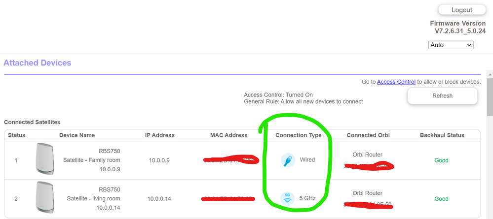

I have a mesh network made of one router and two satellites and have been having issues with the ethernet overhaul and overall network stability (probably because the satellites keep jumping their connections from the router to the other satellite).
My router is connected to my ISP modem and then to a switch. Then I have each satellite connected to the switch via ethernet cable. This was working perfectly for 4 weeks and my whole house was fully covered with a very stable network.
A family member came over and did something to either the router or one of the satellites and now my whole network is a mess (I wasn't home and didn't see what he tried to do).
The issue I see is that the satellite is connected to the router via Wifi instead of Ethernet (or that it keeps changing from wifi to ethernet) even though the cable is physically connected and working (I connected directly to laptops, Apple TV, etc). How can I troubleshoot this?

      When I disconnect the "living room" Orbi from power, the network goes back to being fully stable. Once I connect it, even the other wired connections have instability, so, the problem is definitely in that satellite.
