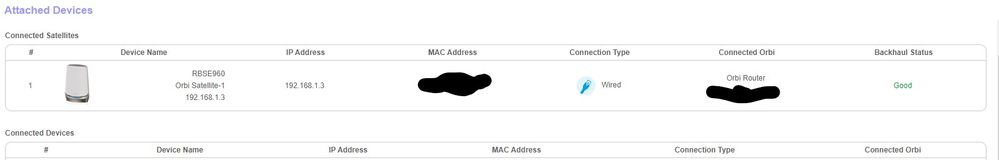

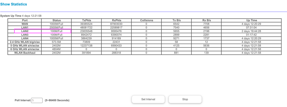

I have set up my new Orbi 960 wifi mesh for 2 week now. I have connected the Router and Satellite via. CAT6 cable (Wired Backhaul). I noticed the link speed (LAN 2) between the Router and Satellite is capped to 100 mbps.
This is very strange, not able to get this right. Please someone advise.speed

Furthermore my Orbi Web interface says "Backhaul Connection Status : Good"
Am I missing something.

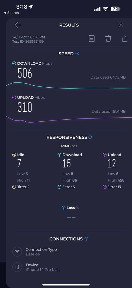

My Orbi RBRE960 (Router) is connected to ISP modem and my Internet speed is 500 Mbps.
When I pull an internet speed test from a device (iPhone 14 pro Max) attached to RBSE960 (Satellite) I get speeds of 506 Mbps. This does not justify the backhaul link speed of 100 Mbps shown in statistics window.
Can someone help me understand what’s going on here?- FURRYe38Guru - Experienced User
What speed do you see on the RBRs status page if you connect the back of the RBS using it's 2.5Gb Lan port to the back of the RBR on it's 2.5Gb LAN port? Just a quick test is all thats needed. Please post the screen capture.
