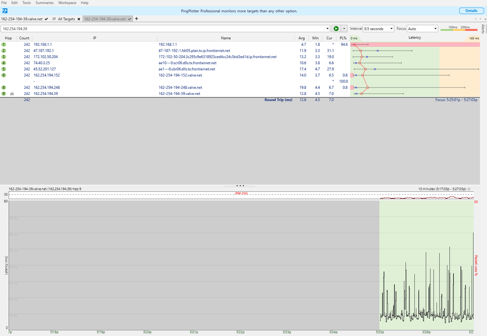

Packet delay spikes at regular intervals
Hello, I would like to start this stuff and am going to information dump a lot of what I've attempted.
To begin, I've noticed since a few months ago ive begun to get debilitating jitter in the games ive played and finally started to look into it.
I have an an Orbi RBR750 router with 2 separate RBS750 satellites. One is placed upstairs and another (the one I'm connected to by ethernet) is placed roughly 60 feet away in a separate room. The satellite i am wired to is also wired to a SmartThings hub and the Orbi router is connected to a TP-Link TL-SG108 8-port gigabit desktop switch.

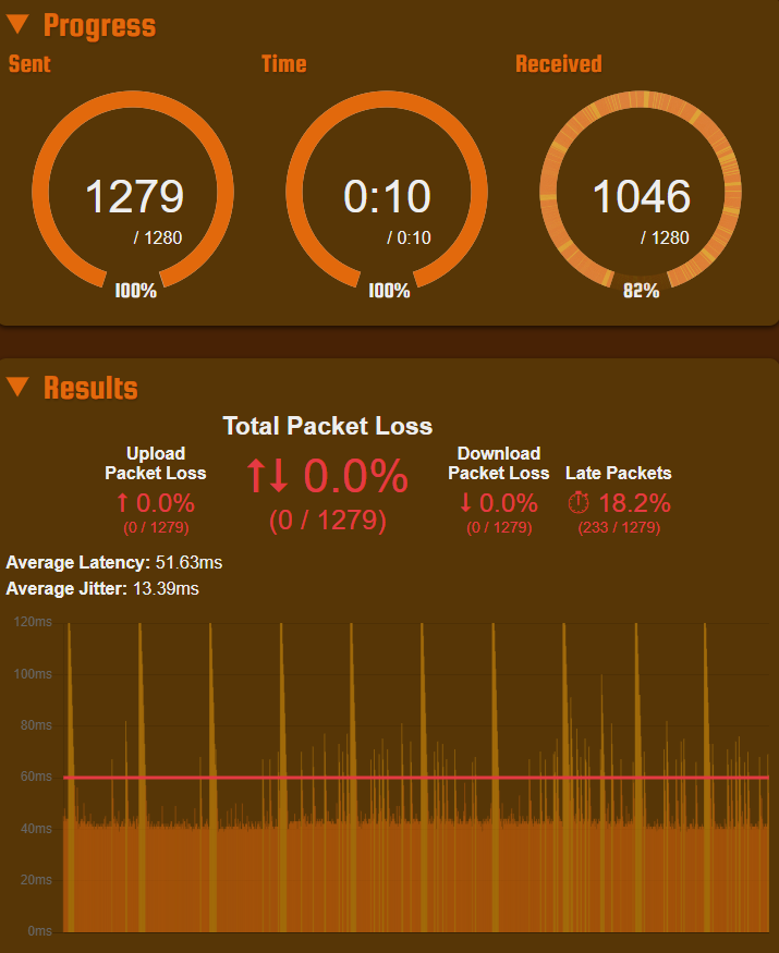

Connected to the satellite, I see 20% packet delay with 0% packet loss and when connected directly to the switch i see no packet loss or packet delay. When i connect the satellite directly to the switch i also see no packet loss or packet delay. I will say that pingplotter states im losing 95% of packets but i dont believe that to be true.
These are a breakdown of the tests ive tried thus far.
Ping Plotter to valve servers:
Ping directly to my router:

Packet Loss Test:
I have also run a Wireshark test but i have no idea how to make that info intelligible to me.
I would greatly appreciate anyone's help here and am open to all suggestions.
