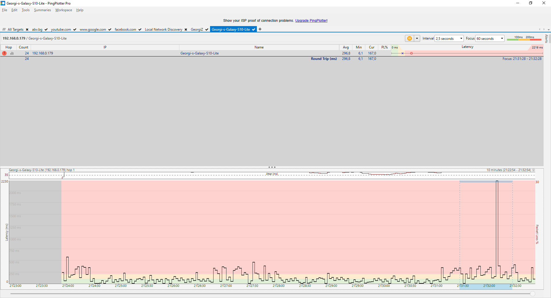

- ninjata12Sep 01, 2022Aspirant
So, what brought up the subject was general lagging, even when browsing. For example sometimes simple news pages won't fully load, photos missing, etc, so I have to press F5 and refresh the page, so that I could see everything. I am day trading, so sometimes I lose connection for a second or two, which messes up the order flow, the history charts and so on.
About other devices, here is what PingPlotter shows for my phone, please see it as attached file:
