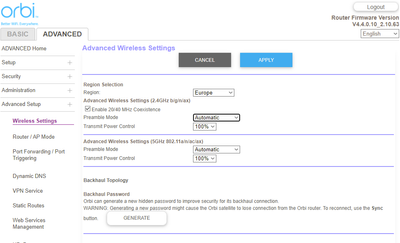

  • Try this to see if it improves your wireless compatibility for your cameras and other older 2.4Ghz devices:
    1. Go to the web admin portal at http://orbilogin.com/
    2. Click to the Advanced tab, Advanced left menu, Wireless Settings
    3. Set CTS/RTS Threshold to 2347 for both 2.4hz and 5Ghz networks
    4. Press Apply
    See if that helps.  If problems still persist, next try disabling AX mode for the 2.4Ghz band:
    1. Go to http://orbilogin.com/
    2. Click to the Advanced tab, Setup left menu, Wireless Setup
    3. Uncheck "Enable 2.4G" under the top Enable AX section
    4. Press Apply

        TerjeSly wrote:
        I can not find that choice
        Apologies, your RBR350 doesn't have AX mode so just try the CTS/RTS Threshold change.
