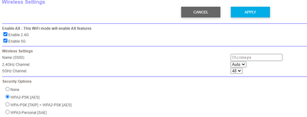

Question on RBR750 for 5GHZ Channel setting
Is there any recommendation on the 5Ghz channel that is set to 48. See the attachment for more information

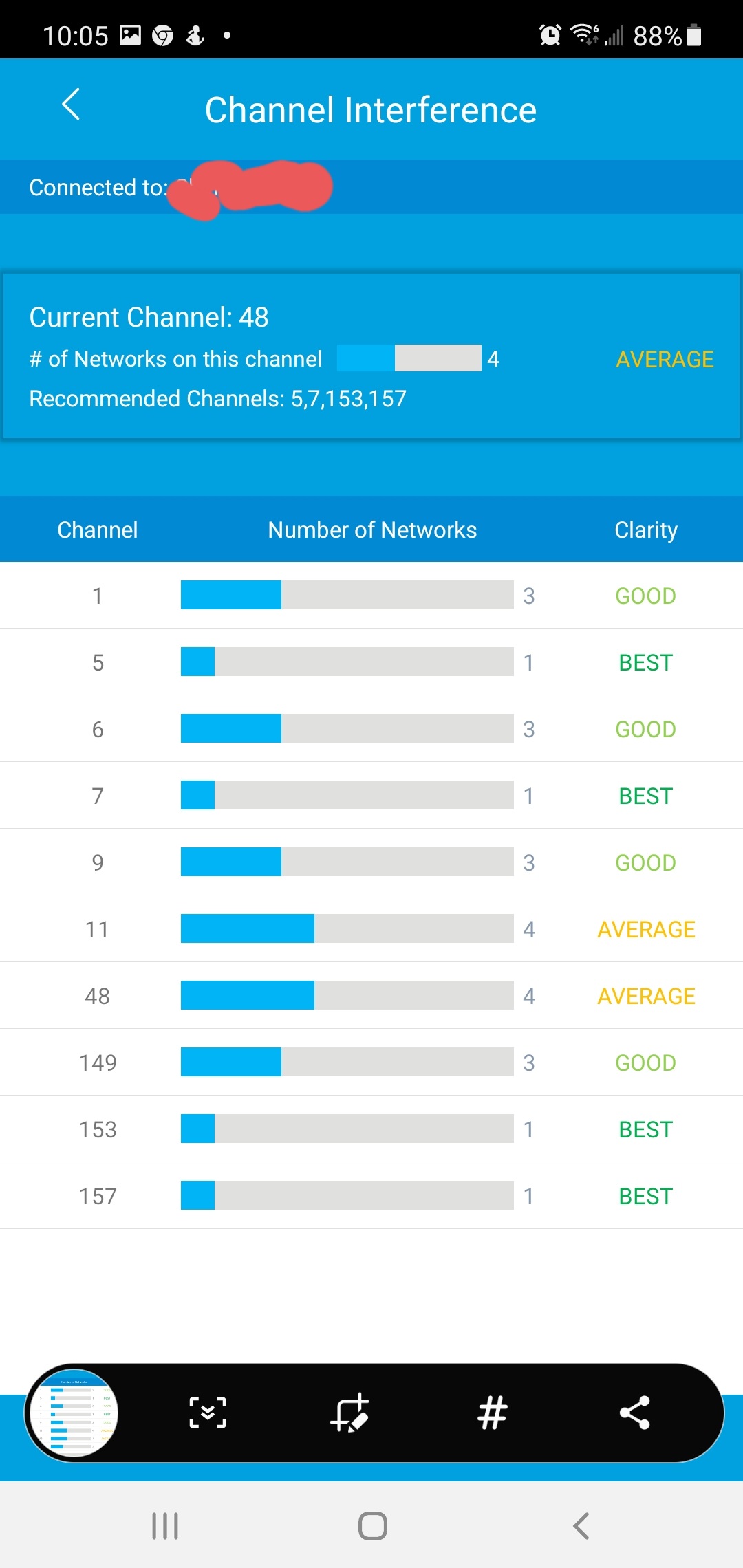

Here is the app picture uploaded
Jul 21, 2021Guru - Experienced User
Well over all the channels seen are for general idea and what the app detects from your surroundings. I presume the back end scanner used in this app is also used in other non Orbi apps as well which those products you can select higher channels, (149-157) However on Orbi systems, 36-48 is only availalbe for users to select from. The higher channels are used by the Orbis WiFi back haul system and not configurable by users. So whats see on the app is just a suggestion and not necessarily something you have to do. And for Orbi, theres only 36-48 so thats all you can do. You can use scanners however there suggestions may not be applicable in some cases.
Seems like yoru app doesn't mention 36-44 so maybe these are busy with other wifi signals.
I tend to use a wifi scanning app for a mobile pad, these offer better results and you can see whos near by and what they are using in channels.
