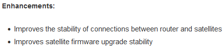

https://kb.netgear.com/000065814/RBRE960-RBSE960-Firmware-Version-7-2-6-21-for-all-regions-except-Europe
Notice that the announcement mentions - Some customers actively watch the support site and manually update firmware. Since this post is specifically about the router-satellite connection, perhaps it would be worth doing a manual firmware update to see if "anything changes".
- I have seen new firmware remain in this "do what you want" state for months (and months). Eventually, Netgear usually "does something" so that the customer routers detect the new firmware and offer to update. Most of the AX series Orbis now have a customer option to allow (or prevent) Netgear from automatically updating firmware. (My older Orbi lacks this option.)
- At some point, Netgear may decide to push the update to customers, which the Terms and Conditions say they have the right to do.
