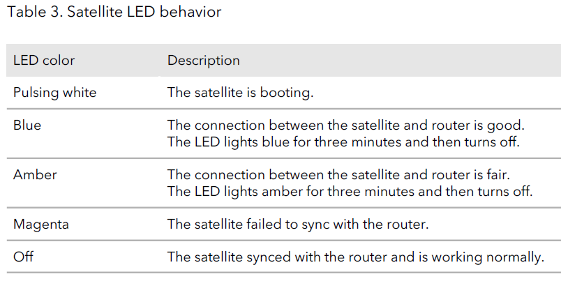

However, the satelite will randomly lose its connection at least once every hour. Sometimes more often. It will start pulsing white, then after a while beocmes solid blue and then the led will turn off.
According to the User Manual, page 11, this is how the satellite LED is supposed to behave:
Could the electric plug be loose, causing the satellite to reboot?
Does the Orbi web interface or the Orbi app show devices connected to the satellite?
- Koma07AspirantThanks for taking a look, CrimpOn.
Correct. That‘s how the satellite should behave when it‘s initially connected to the router. But can‘t imagine it‘s supposed to be rebooting randomly throughout the day (hence the pulsing white LED)?
I‘ve switched satellites, chargers and electric plugs so I don’t think it’s related to the electricity. My guess is it‘s must be something between the router and the satellite.
