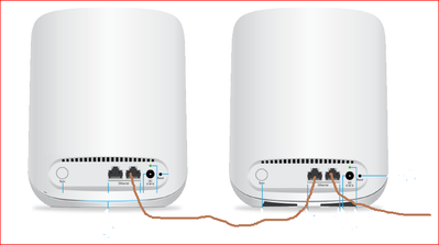

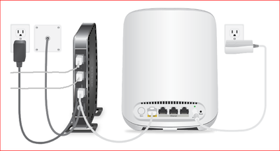

But can I double the bandwidth by using two satellites in parallel?  I propose having the RBR350 (router) connected to my ISP modem, but not so close that the WiFi of the ISP modem does not interfere with the Orbi WiFi.
I then propose placing the two satellites close together, but 5m away from the RBR350, with wired connections between them:
My assumptions (hopes) are:
  1. Although there is only one router RBR350 box, it has sufficient capability to talk to each of the two satellites simultaneously.
  2. The firmware supports packet distribution to each satellite and subsequent ordered reassembly at the destination.
Is there anything to gain from this arrangement, or am I just deluding myself?

    But can I double the bandwidth by using two satellites in parallel?  I propose having the RBR350 (router) connected to my ISP modem, but not so close that the WiFi of the ISP modem does not interfere with the Orbi WiFi.Is there anything to gain from this arrangement, or am I just deluding myself?
    Alas, worse, not better.  All Orbi systems use one 5G WiFi channel for communication between the router and satellites.  WiFi is inherently a "one device at a time" medium.  When the router broadcasts, the satellites must wait until it quits before one of them can broadcast (and the other satellite continue waiting).  When either satellite broadcasts, the router must wait.  The more satellites, the more waiting.
    The 350 system uses the same 5G WiFi channel to communicate with user devices.  (this is the primary distinction between dual band WiFi mesh systems and tri band.)  For many users, their network usage is light enough that one single 5G channel provides a fine experience.  The original Google Mesh was a dual band system and Google must have sold a gazillion of them.  In this case, the more WiFi devices there are, the worse the performance of that NAS backup.

      I ran some experiments.  For the benefit of other readers, the arrangement shown above with a wired connection between two satellites does not have the desired effect, one of the satellite is seen as "Wired" and all the backhaul traffic goes via the other satellite. [Credit to Netgear for recognising this scenario and blocking potential pitfalls like packet collisions.]  However, instead of a wired connection I connected via web managed switch (Netgear GS108Ev3) using the VLAN capabilities. Each orbi satellite is allocated to a separate VLAN (so they cannot see each other) but the other devices wired to the switch were on both these VLANs (they could see both satellites).
      Speed tests (using 1GB file transfers between local devices, rather than speedtest.net which is dependent upon internet and ISP QoS) show some interesting results.  It happens that the speed of each satellite is sufficiently distinct that I could tell which satellite was being used.  Over a sequence of 16 1GB file transfers, some packets were routed via one satellite, and other packets via the other satellite.  I think this is random (rather than picking the fastest).
      Even more intersting was when packets were exchanged simultaneously between two devices attached to satellites and two devices attached to the router.  Given only one radio, I would expect half the speed for each pair.  But I actually got more than half. (Single pair exchanging packets: 543.429 Mbps, simultaneous: 373.543 Mbps).  I'd be interested if this suggests more than one radio is being utilised.
