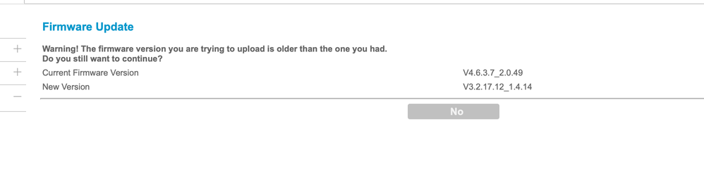

No yes buttonAirprint has stopped working after this update was forced out. I can't roll it back either.
There is no yes button. This is in safari and this is also the case for firefox.
NG is aware of the problems and also recommended disabling AX mode as well. Lets all hope the next FW update fixes this. Please be patient.
