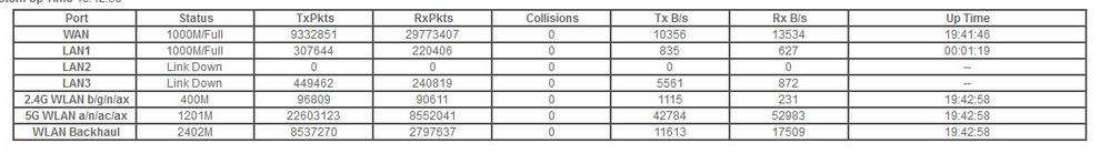

      What is the connection rate seen on the RBRs Advanced tab/Show Statistics button.
      Not sure where you find this, I've pasted the statistics page below.
      There you should see LAN ports listed. 1000Mpbs should be seen next to each LAN entry.
      1000M/Full on LAN1.  LAN2 & 3 show 'Link Down'
      Whats the WAN port speed seen here as well? Should be 1000Mpbs too.
      1000M/Full
