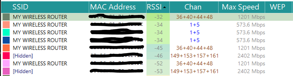

AX4200 Tri-Band WiFi : 2.4GHz (600Mbps) + 5GHz (1200Mbps) for WiFi devices to connect to the Internet. 5GHz (2400Mbps) dedicated WiFi link for faster data connections between Orbi Router and Orbi Satellite.- larryindublinLuminary
And here's some visual confirmation the backhaul is at 2400...
- MstrbigMaster
Yep same here.
