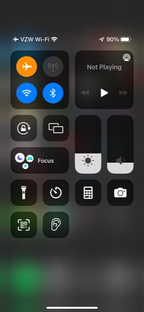

  • I had the same issue on both mine and my wife's phones start a couple of days ago. I spent 10 hours on the phone with Apple, Verizon, Comcast, and Netgear troubleshooting and resetting everything yesterday, to no avail.
    Today, I may have stumbled on the fix. I can't believe it's as simple as it is.
    In the control panel on the iPhone,
    The phone has to be in airplane mode, and the cellular antenna button has to be off. This forces the phone to use the wifi signal, and not look for the Verizon signal at all. Picture attached. Hope this fixes your issue as well.
