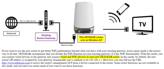

Just a nitpick here: Neither of the KBs you link to specifically state that the satellites will continue to work with the router in AP mode. The router's "Learn more" link says nothing on the subject either and could easily be interpreted that the router itself is the only device you can connect to when in AP mode:
Fortunately, the Youtube video (sort of) gives a graphical reassurance that they do.

Yes it's presumed that the RBS with the RBR in AP mode, will work. Have seen some odd issues for some users. Sometimes the host router doesn't hand out IP addresses correctly or there is some odd sync problem.
