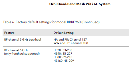

    You can't change the backhaul channels. And it usually is the higher 4ghz channels for backhaul with the lower used for the fronthaul

    This is correct.  Each Orbi unit (router and every satellite) communicates with user devices (Fronthaul) on the same channel (40 in your case).  WiFi Analyzer programs, such as WiFi Info View for Windows and many Android apps, will show each of the Orbi units on the 2.4G and 5G channels.
    In my case, with one router and three satellites, using both primary and guest WiFi, that means that eight access points show up on the same 2.4G channel (4 primary + 4 guest), eight access points show up on the 5Ghz fronthaul channel, and four access points show up on the 5Ghz backhaul channel.
