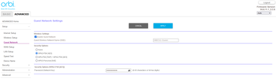

I have a RBR 750 in Router mode, and I'd like devices connected to the guest network to use chromecast which is on my main network.
Ideally, I would expose the Chromecast device (and only that) to the guest network, but it looks like that is not currently possible and posted as an idea for future implementation: https://community.netgear.com/t5/Idea-Exchange-For-Home/Shared-resources-between-Main-Guest-6GHz-Iot-networks/idi-p/2208810
It looks like others have solved similar issues by changing the setting "Allow guests to see each other and access my local network", which I don't see in my network admin page (see attached screenshot). Is it not available in the RBR750?
If so, do I have an option for having my guests cast over Chromecast, other than just having them connect to the main network (which sorta defeats the whole purpose of having a guest network)?

  • CrimpOn's avatar
    CrimpOn
    This was (and remains) an option on the original Orbi series, but which has never been present on the AX products.
