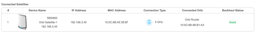

I've factory reset the RBS multiple times in the past three hours because RBR wouldn't list it as a SATELLITE ... tried web interface and orbi app (Android) wired and wireless but it it was just listed as an "External AP" it synced SSID name and password but didn't change admin password (it remained "password")
After 3 hours I reverted firmware to 4xxxx (Both RBR and RBS) and Satellite is fine
PS: i've regenerated Backhaul password multiple times ...
I really hate that satellite sync response is just a led color ... (blue, amber, magenta ...) because when syncing RBS with RBR it was always blue
I'm OK with 4xxx, I don't need IoT or WPA2/WPA3 ... maybe i'll try next update which is supposed to be released in 202x (?) or if price drops i'll try Asus zenwifi pro et12 or wait for wifi 7 ...

      FURRYe38 Don't worry about this thread (it should have been an answer in the New - RBR850 / RBS850 Firmware Version 7.2.6.21 Re... thread not a new one).
      To answer some of your questions i know the meaning of the led colors (i own an orbi mesh system since 2017):
      reset RBS -> amber led on the back -> white pulsing led on the front -> wait -> wait -> wait -> solid white led on the front -> press sync button on the back -> pulsing white led on the front -> press "SYNC" button on the web interface "Add satellite" -> pulsing white led on the RBR -> wait -> wait -> pulsing blue led on satellite -> "Satellite synced successfully" on the RBR web interface -> more waiting -> even more waiting ... led on satellite is off -> everything should be OK but under firmware 7xxx Satellite was listed as a "normal" device NOT under "Connected satellites".
      When updating to 7xxx satellite was updated before the RBR.
      When i first updated my mesh system everything was fine but 2 days later (this morning) satellite was unable to "forward" DHCP requests to clients ... it was "out of sync" although connection in the RBR web interface was GOOD
