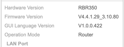

I had an ORBI RBK50 with two satellites that were ethernet backhauled.
Absolutely loved it until it bricked itself one day. I ran down to the store and bought an AX1800 RBR350.
I run in router mode. ethernet backhaul, same network name etc
Since then I have the following issues:
1) WIFI is awful.  when I unlock my iPhone and attempt to browse (the news for example) nothing happens, and I mean nothing...... if I turn the wifi on the phone off and on then suddenly works.
2) I can be working from home and suddenly everything connected to the WIFI loses the WIFI.  If I attempt to connect my phone to the network WIFI I get a spinning circle and nothing.  That is until I reboot the router and suddenly we are good again....
3) I used to be able to play my PS5 games via my MacBook using the playstation remote play. No on the RBR350 it is not at all playable, even if I dial down the quality and frame rates as low as possible.

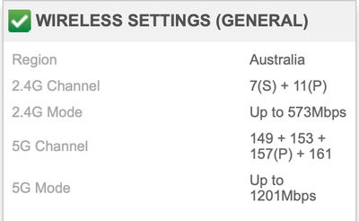

Lastly, when I reach out to get support I get told to log on and change the 2.5 and 5G channels. But all of 2 mins on these pages shows that you are NOT able to change the 5G channel......
Is the RBR350 just a really poor piece of rubbish or is there something I am doing wrong?

    What channel configurations are currently set on the router?
    https://kb.netgear.com/23783/How-do-I-change-the-wireless-channel-on-my-NETGEAR-router

    Ya, the 5Ghz channel can't be changed on the 350 series.
    The 350 series was NGs low budget entry for the Orbi system. I'd recommend a 750 series to be honest.
