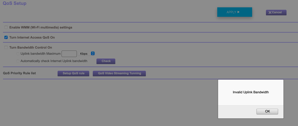

Digging around on the community posts here, I found reference to http://orbilogin.net/QOS_main.htm which is supposed to help me set up QoS on the router.  I will say this page does absolutely less than nothing and I'm not sure why it exists.  Clicking on the text on that page gives me a pretty detailed help page at the bottom of the window, but literally none of that stuff comes up when I click on "Turn on QoS" (see orbi-RBR750-qos.png attached).  I can't change settings, because one of two things happens.  Either I get taken to a speed test page with no way to get back to the QoS settings, or I get an error "Invalid uplink bandwidth" (posting inline here):
I feel like I should be able to change these settings, or at least to be able to start large downloads without something deciding to devote the entirety of my network resources to getting that file, and ONLY that file, and abandoning all the currently open connections as a result.  I've just about had it with the Orbi system, to be quite frank about it all.  I'm currently looking around to replace this system, because this is kind of ridiculous how I can EITHER do a big download OR work, but I can't do both together.
