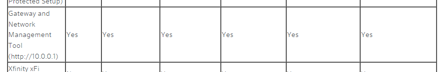

    While many of the products have distinct links to download the user guide, there is no link to a guide for this product.  The table at the bottom of the page claims there indeed is a Gateway and Network Management Tool:
