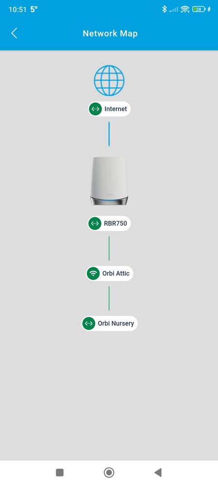

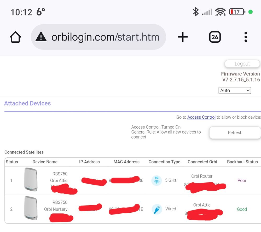

RBR750/RBS750 Backhaul Problem
I have the RBK753 which contains a router and 2 satellites. I live in a 3 bed semi-detached home. On the ground floor I have the router. On the first floor in the nursery, I have a satellite (about 20ft away from router and it has to go through wooden floor).
I then have the nursery satellite connected to a satellite in the attic via ethernet. The attic is fully soundproofed with multiple layers in walls and floor.
My hope was the router would connect to the nursery satellite wirelessly. Then the nursery to the attic via wired connection. What is happening is the router is connecting to the attic wirelessly (poor connection) and then the attic is connecting to the nursery (wired).
I reduced the power on 2.4 and 5Ghz on all devices in the hope that it would force the router to connect to the closer nursery satellite but this is not the case, still the same connection order.
I've attached some screenshots, any ideas how I can force it to connect to the closer satellite - thanks.
    What happens if you disconnect the ethernet and power-cycle all three mesh elements?  Does the backhaul daisy-chain through the nursery, or does it stay (poorly) connected to the router?

    • Philboy01's avatar
      Philboy01
      Thanks for your reply.
      The satellite in the nursery is 20 ft away (has to go through a wooden floor and is sitting on top of a dresser).
      I put an Ethernet cable from the nursery to the attic, as I was hoping that the following would happen:
      1. Router on ground floor {wirelessly connects to} Nursery Satellite on first floor.
      2. Nursery Satellite on first floor {wired ethernet connection to} Attic Satellite on second floor.
        • Note: Wired to prevent signal issues through the 7 layers in the floor for soundproofing.
      I did what StephenB suggested above (disconnect Ethernet and power cycle all 3 devices), and it now connects in the order that I had preferred, albeit fully wirelessly. The signal is reported as Good on both connections listed above, which you can see in my screenshots below.
      Do you think the ethernet connection is possible not installed right or some backend configuration issue in Orbi admin? Is it ok to plug the Ethernet into any port?
      Thanks,
      Philip

      • FURRYe38's avatar
        Can you provide us a floor drawing layout diagram and mark where you have the RBR and RBS placed?
        20feet is going to be too close and maybe causing the attic RBS to connect to the Nursery RBS since the wifi single over lap between the RBR and closer RBS is too close or too much over lap between them. Can you move this one RBS out farther from the RBR?
        Something you can try, turn down the power on the RBR from 100% to 50% on the RBRs web page under Advanced tab/Advanced/Wireless Settings.
