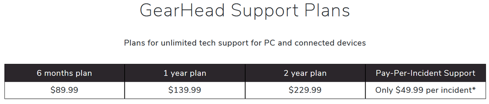

Netgear offers residential customers several levels of support via a subsidiary called Gear Head (get the pun?)
Scroll down this web page: https://www.netgear.com/support/ to reach a link to this site:
https://www.netgear.com/home/services/gearhead/
Scroll down the page to see that Gear Head offers three plans:
Notice that none of these plans costs $299.
