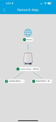

Hello,
I connected my satellites while wired and then disconnected them and placed them throughout the house. This morning I noticed one of them shows up in the network map as a wired device, while the other satellite correctly shows as wireless. How do I change it so it correctly recognizes itself as a wireless satellite? Does it hurt anything if it thinks it is wired? I tried to re-synch the satellite but it did not recognize it because it had already been connected. I have not tried to reset it and then re-add it.

    Got a screen capture of this from the RBRs web page and Orbi app?

    • krlawless's avatar
      krlawless
      Here is the screen capture

        I presume the Guest RBS is the one that is actually wirelessly connected and shows wire connected in the Orbi app?
        Might try this later on, Power off both RBS, swap RBS locations with each other then power ON one at a time, see if the Guest RBS mis-connection type shown clears or follows the one RBS.
