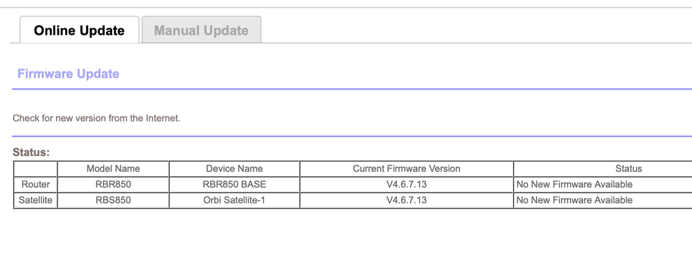

  • Update:
    Firmware update worked (manually)
    I'm such a dummy.
    I didn't realize that there were TWO firmwares, one for the router and one for the satellite.
    They are not the same file, and my error message above was because I was trying to install the router firmware update onto the satellite.
    Anyways, I downloaded two firmwares, one for router, one for satellite.
    I installed the satellite first
    Then the router, as recommended.
    Both installed, as you can see below.
    And now I will wait and see if this fixed the problem of lost internet connectivity. Will let you know.
    But please Netgear, we really should not have to go through this to update our firmware and have a stable internet connection. I should be able to do this from the Orbi app.
    Thanks for the help of both the experts who contributed above. Really appreciate the goodwill people show in helping others. 🙂
