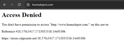

I had an older Orbi system (AX4200) and was gifted this RBR850 (AX6000) kit. It was fully installed and going about our business until I wanted to source parts to build a chicken coop. For some reason, neither Lowes nor Home Depot's site would load and appeared blocked.
I got baffled and wondered if it was the internal network so I turned on my VPN and sure enough, the Home Depot site fired right up!
So I do a bit of googlin' and find This Fix on this Netgear support site. It did not work
I saw someone suggest changing DNS servers, and I have tried them all, but currently set to 8.8.8.8, 8.8.4.4, changing them between top DNS providers made no difference.
Someone suggested to add a Block Services setup for HTTPS but that did not work either.
I saw someone suggest attaching the router's MAC address and I tried that but it did not work. I looked closer and it turned out that ORBI was pre-filling in the MAC address but the last digit was an "E" instead of an "F".
I rebooted the modem and the router and pow! Home Depot and Lowes both work fine now

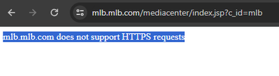

So I go to watch a baseball game and MLB.tv now gives me this error:
mlb.mlb.com does not support HTTPS requests
Some of these sites I hit now don't error like like they did before but now it will be a blank landing page. For example "homedepot.com/lander" (not a real site just an example)
Extreme unlikely we're facing a router issue here - this message does come from edgesuite.net, the Akamai Technologies content delivery network (CDN) blocking the public IP address you presenting there, this is typically the public IP address assigned to your Internet connection, and finally your router WAN/Internet port.
Very likely your ISP does dynamically assign typically changing IP addresses - so Akamai does no longer block your connection.
This URL does neither connect by http nor by https. So completely unclear from where you have got that URL.
