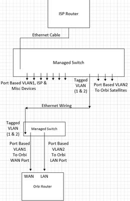

        One situation that has come up on the forum is adapting network gear to existing in-house wiring. It is now common to find a house "pre-wired" with Ethernet jacks located in many rooms of the house, each with a single Ethernet cable running to a patch panel in some location.  Often this location was chosen because at the time it seemed a good compromise between cost, ease of installation, and other factors.  The installation often included coaxial cable to bring the Internet Service Provider signal to the patch panel.  (Optical fiber is a relatively recent development. Often WiFi was limited to 2.4G which has greater coverage area than more modern 5G - and now 6G.)
        From posts on the forum, it has become clear that some users do not find the patch panel location suitable for their WiFi router.  They want to place the WiFi router somewhere else and also locate satellite units in other locations.  Alas, there is only one Ethernet cable from the patch panel to each location. While it may have been routine to install cable when the walls were open, retrofitting more cables can be a nightmare (expensive, disruptive, etc.)
        This can lead to situations like this discussion.  Place the ISS router and a switch at the patch panel and connect everything in the house to the switch.  Netgear's Orbi product, however, is not designed for this.  (Maybe other products are?)
        There was a discussion on the forum about how to use one Ethernet cable to carry:
        • The ISP connection from the patch panel to the router WAN port, and
        • The router connection from LAN ports to satellites
        The concept is illustrated with this diagram:
        The managed switch at the patch panel has two port based VLANs:
        • VLAN1 connects the ISP router and any miscellaneous devices around the house.
        • VLAN2 connects the Orbi satellites to the swith
        There is one "Tagged" VLAN port, which carries VLAN1 and VLAN2.
        At the WiFi router location, there is a second managed switch with two port based VLANs:
        • VLAN1 carries traffic to the router WAN port
        • VLAN2 carries LAN traffic destined for Orbi satellites
        There is one "Tagged" VLAN port, which carries VLAN1 and VLAN2 traffic.  In addition, if the user desires, miscellaneous devices can be connected to this second switch as Port Based VLAN (1 or 2. Doesn't really matter.)
        The "magic" comes from VLAN tagging.  Once the Ethernet switches have used ARP to discover where everything is, they know which port to use to reach every device.  None of the devices themselves are aware of the VLANs.  If a packet comes into the switch on a VLAN1 port, it can only go to other VLAN1 ports. (Same for VLAN2)  So, packets from the ISP router will never go directly to Orbi satellites, because they are on VLAN2.

    • vader716's avatar
      vader716
      I guess I don't understand the "Orbi expects" part
      I posted the diagram and you aren't far off from the situation.
      I can phyiscally relocate the RBR and could technically put the RBR between the Firewall/Router and managed switch but no way can I get the other two RBSs directly connected.
      I just dont understand (it's me and ignorance I'm sure) why with one IP domain 192.168/24 and switches these Orbi devices can't find each other.
      RBS should say "Hey I'm looking for RBR, this IP or MAC" managed switch says "I don't have it, ARP anyone?"...the other managed switch says yea here.... and traffic flows.  Sort of the way IP and Ethernet was designed.  No?
      Appreciate the time you took to respond.
  • CrimpOn's avatar
    CrimpOn
    Thanks for posting the diagram.  Very helpful.  I am guessing that the green lines are manufactured Ethernet cables with RJ45 plugs on each end and the red line is Ethernet cable terminated at one end in an RJ45 jack on the wall and at the other end in a patch panel.

    • Install a second Ethernet cable from the basement to the router to connect a router LAN port to one of the Port based VLAN ports on the basement switch.  This will avoid purchasing another managed switch so that the single cable between basement and router can carry both WAN and LAN traffic.
    • Purchase another managed switch to place near the router so that the single Ethernet cable to the basement can carry both VLAN1 and VLAN2.
    The cable would cost less than another switch.  Depending on the building structure, installing another cable might be almost trivial (or a nightmare!)
    No matter which solution is chosen, the upstairs switch also needs to have VLAN1 and VLAN2 implemented and the port linking the upstairs switch to the basement switch needs to be a Tagged VLAN (also on the basement switch) so that both regular traffic and the router-satellite link can use the single Ethernet cable.
