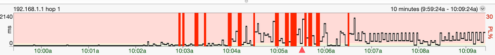

Over the past three weeks, I've been having the occasional odd behavior with my RBR850 router. Everything will be working properly with very fast response times and then all of a sudden I'll start experiencing packet drops, lag spikes, and then a square wave profile to router ping response times as shown here from a PingPlotter screen grab:
In the above, packet loss is about 10% and average ping response time is 290 ms and will eventually revert back to normal behavior. I was first tipped off to an issue when my boys were complaining that they were "lagging hard" while gaming.
I'm on the latest firmware (v 4.6.9.11) and this is the first time in 10 months that I've experienced issues with my Orbi. The issue will reappear following rebooting.

        Do you see these same or different ping plotter results with the PC connected to the ISP modem directly with out the RBR in the middle?
        Factory reset the RBS, then RBR then Power off the ISP modem for 30 seconds then back ON. Then walk thru the setup wizard on the RBR...Don't reload any saved backup config from file for now.
