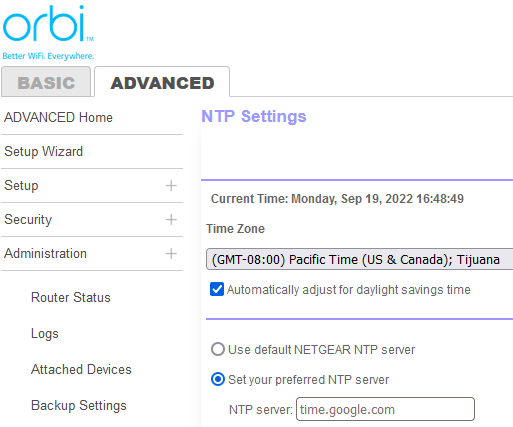

      As stated above. the time zone and NTP is correct!
      I would have added the graphic but only let me pick one. This was 100% working before the update.
      time zone settings picture added.... the time shown in the UI matches the actual time.
      Its a bug.....

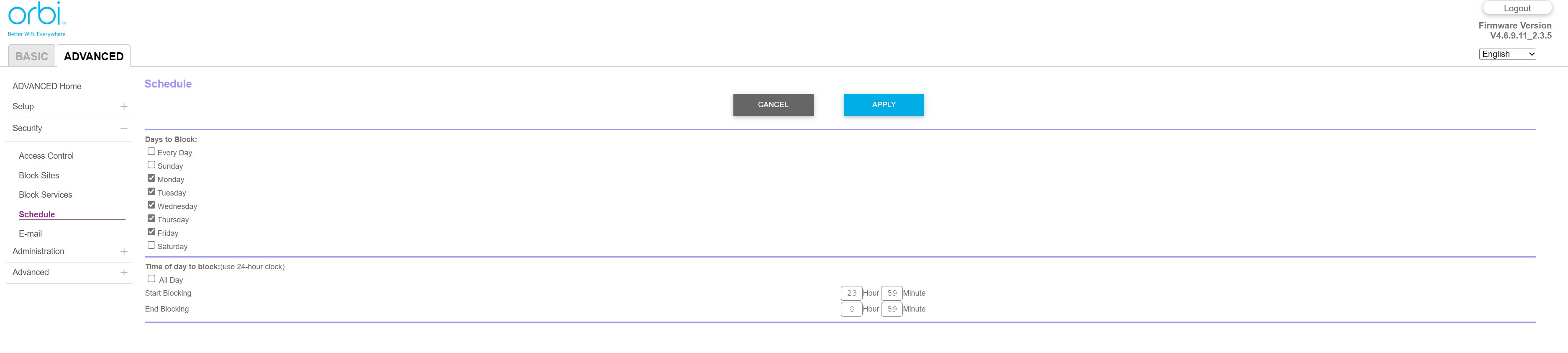

      I am having the same issue. I have a schedule that blocks YouTube from 0200-0700, but I was trying to access it tonight around 2200, but was unsuccessful. I never had an issue with this schedule until now and remembered the recent upgrade to 4.6.9.11. I tried both Netgear NTP and time.nist.gov, with no difference. I will likely perform a factory reset this weekend to rule it out, but glad I am not the only one experiencing this.
