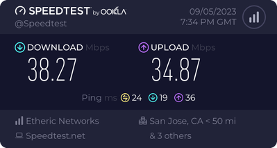

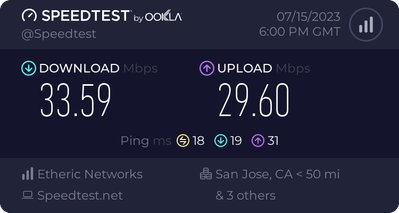

Prior to the upgrade I ran a speedtest:

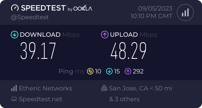

After the upgrade:
Meanwhile the tech showed me the speedtest result on his laptop at ~100Mpbs. And indeed, if I plug a laptop directly into their tufswitch, I get 80-100Mbps. As soon as I introduce the RBR850 I get <40Mbps.

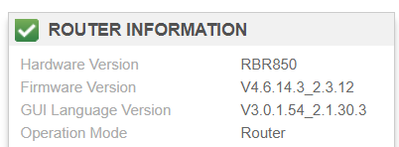

Router info:
I tried multiple devices and multiple cables. In all cases when directly connected to the switch, speeds appear as expected (80-100Mbps). Once the RBR850 is introduced, I get <40Mbps. Not really sure what to try next 😞
