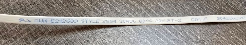

Be sure to use a good quality LAN cable between the ISP Modem and RBR. CAT6A STP is recommended.
I have a CAT 6 but the CAT6A STP is not shown on the side if the cable.

STP differs from UTP.

Here is a screenshot of the LAN cable, sorry I'm not a wire geek, let me know.
