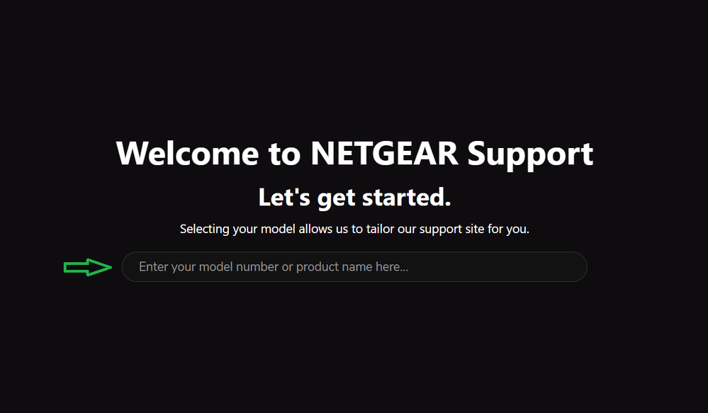

Navigate to https://www.netgear.com/support/ in a web browser.
Locate the model number if need from your main router unit:
Be sure to back up the systems configuration to file, before starting a firmware update for safe keeping:
Nighthawk Mesh: https://kb.netgear.com/24231/How-do-I-back-up-the-router-configuration-settings-on-my-Nighthawk-router
Orbi Mesh: https://kb.netgear.com/000062080/How-do-I-back-up-the-configuration-settings-on-my-Orbi-WiFi-System
Orbi systems will start with CBR, RBK, RBKE or RBE.
Nighthawk Mesh systems will start with MK.

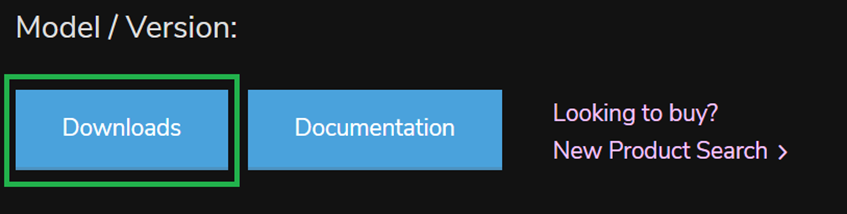

Input the model number of your Orbi or Nighthawk MESH system:
After the model product page displays, select the Downloads button:

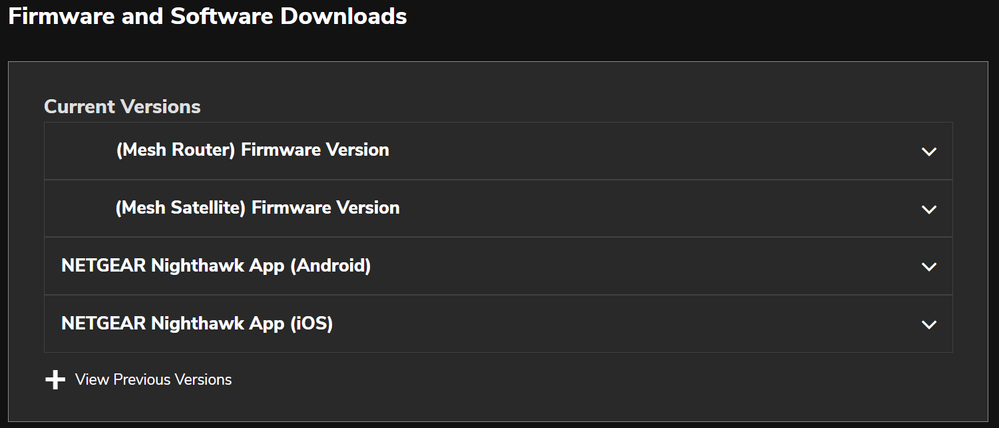

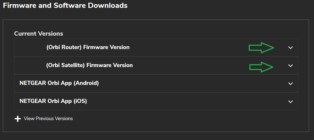

Firmware and Software Downloads will be displayed in the web browser.
Orbi Mesh:
Nighthawk Mesh:
For all Orbi and Nighthawk Mesh systems, there are two separate firmware files needed to be downloaded. Select anywhere on the Current Versions web page to reveal a download or Release Notes link. Select the Router and Satellite options seen: Orbi and Nighthawk Mesh:
A Download button will be displayed along with Release Notes. Two options here to download the necessary firmware files.
1. Select the blue Download button for the router unit then select on the satellite drop down to show the same blue Download button for the satellite:

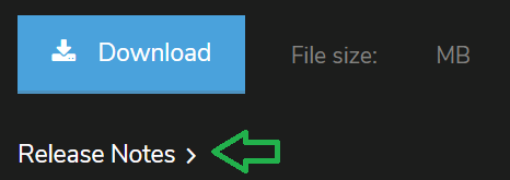

2. Select the Release Notes link under the blue download button:

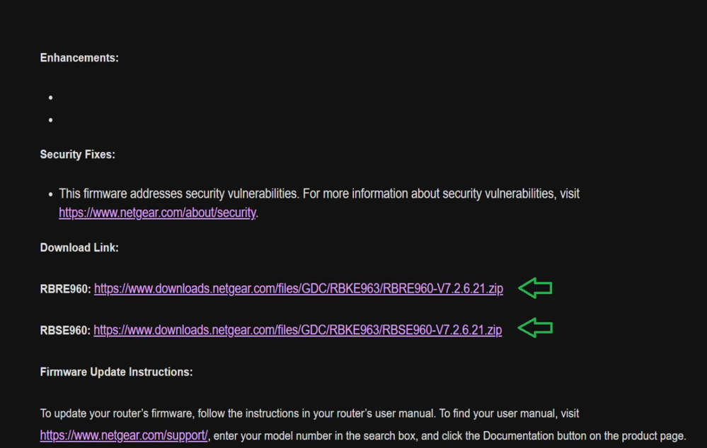

This will open the product system download page and show release note information about what is included in the available firmware update along with download link to both router and satellite units:
Select both router and satellite .zip files seen here, and the file will be downloaded using the web browser to its designated location or have the browser download the file to your desktop, a recommended location. Example is for Orbi 960 series. Same will be seen for Nighthawk Mesh systems as well.

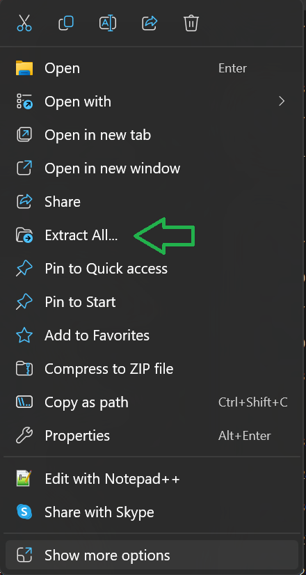

Find and navigate to where the download .zip files are located and right select on each of the .zip files. Right select on each file from the tool menu, select Extract All…
Other .zip file extractors like .7zip or other .zip file extraction programs may be used here.
Extract both the router and satellite .zip files.

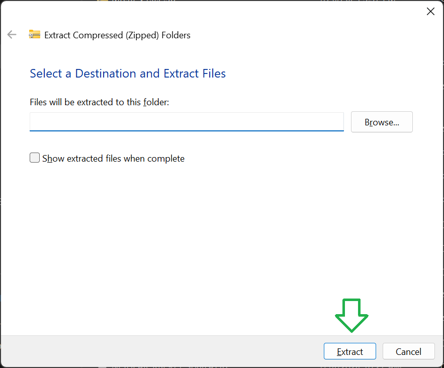

Select a Destination and Extract the files from the .zip file:
Browse to where the extracted files are to be extracted too. Recommended desktop or the default location seen in this window. Users Choice. Select the Extract button and the files will be extracted to this location. Do this for both the router and satellite firmware .zip files.

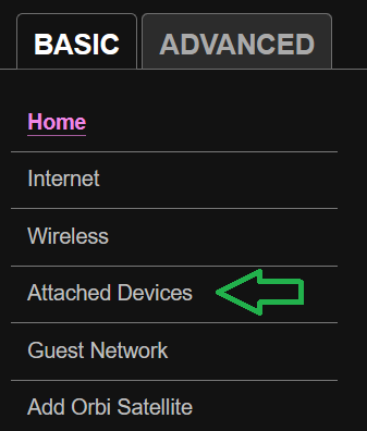

Once logged in, select on the Attached Devices menu option:

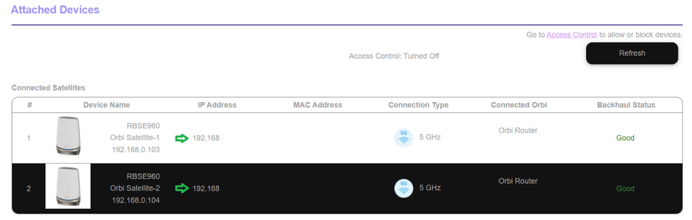

Find the IP addresses for each satellite that’s connected to the router unit:
Use the IP address seen here for each satellite and open a new tab with in your current opened browser for each of the IP addresses seen for each connected satellite.

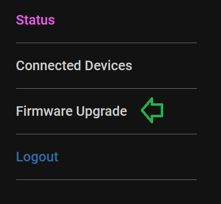

After logging to the satellite’s web page, select the Firmware Upgrade menu option:

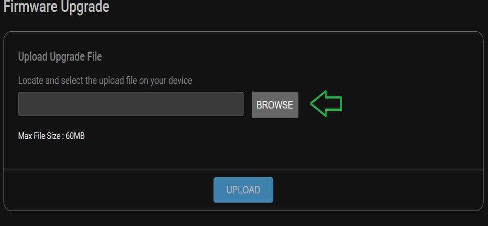

This will display a Firmware Upgrade and Upload Upgrade File window in the browser:
Select the BROWSE button and navigate to where the downloaded and extracted files are located. Find the satellite .chk firmware file first.
After selecting the satellite .chk firmware file, the Upload Upgrade File window will be populated:

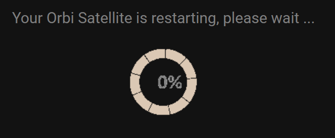

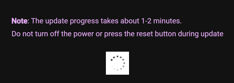

After selecting the UPLOAD button, a note window should be seen giving information on how long the process takes:
Next screen I the browser will be a progress circle:
Observe the front LED on the satellite unit(s). It should start to blink WHITE then as the progress circle gets to 100%, the front LED should stop blinking and turn BLUE for 3 minutes indicating a good sync and connection, then turn OFF, indicating normal operation.
Do not power off the satellites during this operation. Could cause damage and break the operation of the satellite(s).

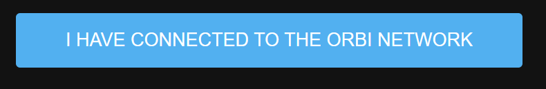

Once the progress circle gets to 88-100%, the satellites web page will update and display the following:
Or Nighthawk Mesh network here as well. Leave the satellite web pages alone here.

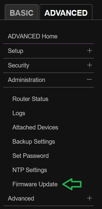

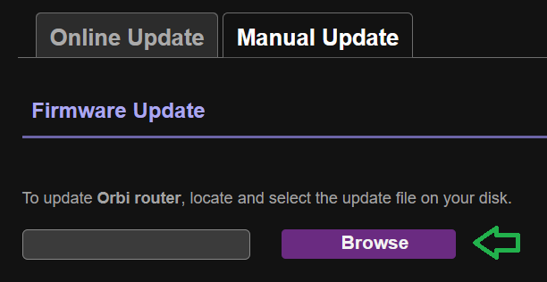

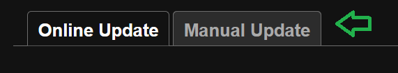

After each satellite has been sent the satellite firmware, send the routers firmware file to the router unit. Select the Firmware Update from the Advanced tab/Administration menu:
Select the Manual Update tab:
Select the BROWSE button and navigate to where the downloaded and extracted files are located. Find the router firmware file. Don’t select the satellite firmware file:
Select the blue UPLOAD button:

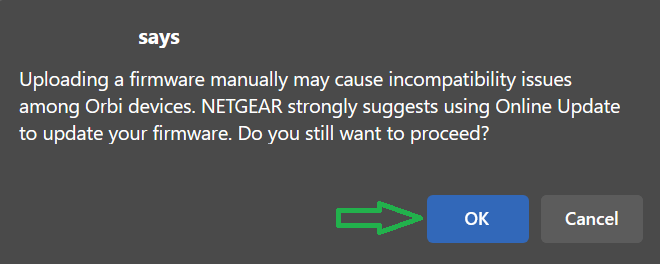

You will see a IP address of the router says message:
Select OK here.

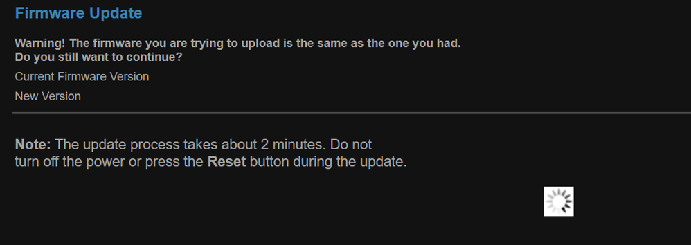

Warning and Note on firmware version and time to process the firmware will be seen:
Then a Rebooting the router now message progress bar will display:
